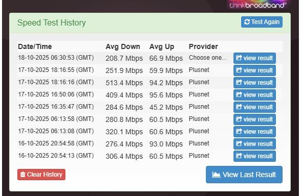

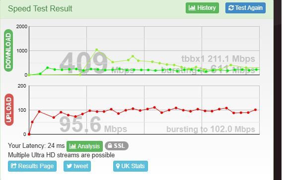

And ThinkBroadband seems to spike up and down :
