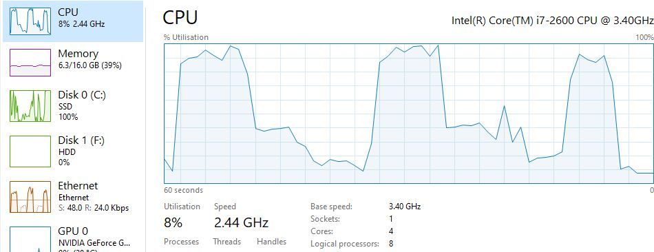

Re: Upgraded from 300 to 900, not getting minimum speed guarantee
20-10-2025 6:54 PM
CPU appears to be high when running it ? Still can get online etc but thought when I seen the offer I'd go for it. Kids all have full 900mb available and I'm the only PC in the house with not full speed.
20-10-2025 7:11 PM
That tells me that the PC is not saturating the NIC (network) but it is hammering the disk and the CPU. Would be interesting to see the user / kernel loads spilt on the CPU.
Look at defragmenting the disk.
Make sure as little as possible little else is running on the machine.
You have though somewhat reached the point of proving that the machine does not have the guts to drive the connection to its full capacity. But what's the real issue? The connection is not holding up what your machine can do ... it is holding itself up ... and would it being different make any real material difference to what you do? I suggest not and that you are probably spending time and becoming stressed over something which will make minimal difference ... unless you you really want to go spend £££s on a brand new high spec PC.
