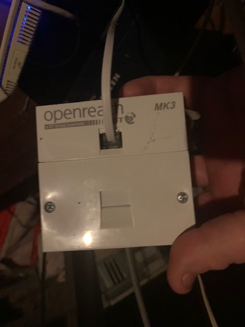

Which socket - a photo would be ideal?
Any markings on it?

Well yes I can take a pic of the BT socket. I would re emphasise though that none of this is new equipment or new changes since my swap to fibre plus.

OK - it is a filtered socket, but maybe - if you have a 'dangly' filter - you could try it straight into the test socket, just to rule out a failing internal filter.

By "test socket" do you mean the empty one below the occupied socket John?
Strat
Posts: 31,320
Thanks: 1,589
Fixes: 565
Registered: ‎14-04-2007
Re: Speed decrease after signing for a new contract
No, the one behind the faceplate.
Posts: 25,122
Thanks: 9,068
Fixes: 385
Nope, @kwikfix - the one which is exposed if you unscrew those two screws and remove that bottom cover - there should be another socket behind that, into which you plug the filter, then plug your DSL cable into the corresponding socket on the end of the filter.
