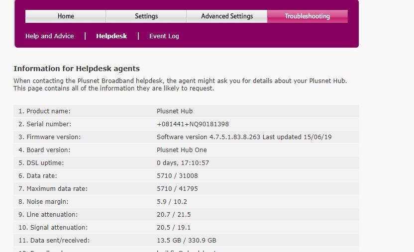

@kwikfix If you post screenshot results of  BT Broadband - obscuring your phone number, BTW Performance Tester - the 'Advanced Diagnostics' report, and your Hubs Help Desk - obscuring personal details, Community members may be able to advise.

Thanks - and the other two? - they are needed to build the full picture.

@kwikfix A picture paints a thousand words. 😉
Also, was the speed test done over wireless or ethernet, and have you done a Quiet Line Test - dial 17070, option 2 - after your number has been confirmed there should be no noise on the line other than the regular 'Quiet Line Test' announcement.

Ahhhh thank you here you go.
Test was done over ethernet. I was getting 29mbps right before I swapped to faster package yet I received slower performance.

Thanks for that - it does appear there is something not quite right. Your D/S noise margin is higher than I would have expected, your uptime is very low - you don't turn the Hub off, do you?, and one vital line is missing - what 'User name' is showing on that page?

I only turn the hub off when experiencing even slower speeds or issues on my network.

My username shows on the main home page of the hub, doesn't show on that helpdesk page.

OK. Do not turn the hub off though, you could eventually persuade the Dynamic Line Management in the cab to think you have a bigger problem than you do, and it may aggressively raise the SNR and reduce your speed, which I kind of suspect it has already started doing, looking at that data.
Good that the phone test is clear, and you have the correct user name in the hub - I was wondering if it hadn't completed setup correctly.
I can only really now suggest you wait for one of the Help Team to pick this up and run some slightly more advanced tests - sorry.

Thanks John. Yep something is certainly not right. I wasn't hoping for miracle jumps in speed maybe the possibility of over 40mbps but certainly not a drop from my consistent 29mbps for years to 19mbps overnight from the switch.
I don't reboot the router on a regular basis as a rule, I did do it tonight after sending you those pics but that was the first time in weeks.
