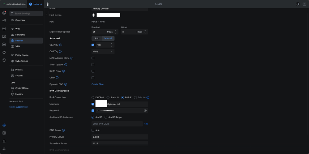

I'm trying to bypass my Hub 2 and connect my ONT straight into the WAN port of my Unifi Dream Router.
I followed this the instructions on this thread --> Plusnet fttp full fibre with Ubiquiti USG - Setup - Plusnet Community, but it doesn't work.
I've attached my settings in Ubiquity's Internet settings but it's not playing.

@dwrightpn  but the real problems are:-
1) your username should end with @plusdsl.net NOT @plusnet.dsl
2) VLAN ID should be disabled NOT set to 101

Oh. So maybe I was an idiot! I'll try that again and remove the VLAN, I did read that had to be set but let's give it a go!
Thanks in advance and if this fixes it then I'll mark your answer as the fix!
[UPDATE] This fixed it! Thank you for spotting my mistakes

As  a mere mortal, I cannot see the settings referred to -  only the dreaded 'yellow triangle' 😀

@jab1 you should be able to see it shortly... I'd forgotten you wouldn't be able to see it. I'm sure you'd have spotted it before me if you had.
