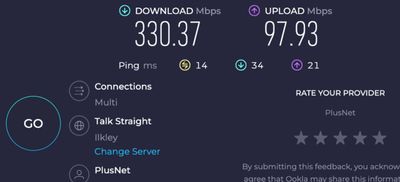

fyi, update from @nathannchan who sent me this image via PM of a speed test over 'wifi' via Hub 2.
Upload speed looks fine to me.
Speed test to be checked using an ethernet wired computer, because Wifi-5 (802.11ac) enabled Hub Two won't ever reach 900 mbps over wifi-5.  (2x2 Wifi-5 may max out 460-480mbps)
