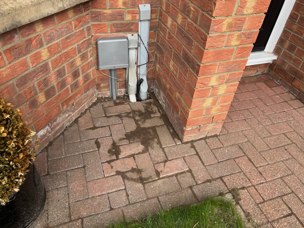

Thanks all, yes confirming the wholesale checker info shared by @Lawrencium103 is for my property (Not sure I know you @Lawrencium103 but I have a hunch Smiley ). Here's the duct. Left is openreach duct, right is for my 4 x Ethernet.
I'm thinking of running another length of flexi conduit as there's space to tuck it up behind the openreach duct under the cover. The technician can then hopefully just come out here and loop back down into my conduit to point B. Failing that I can let them install at A and use @mwwagain 's suggestion and run a fibre extension along my flexi conduit. That might actually be the best option anyway as then the ONT can be moved back to the living room in future if we move.

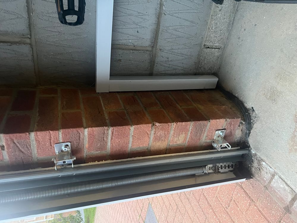

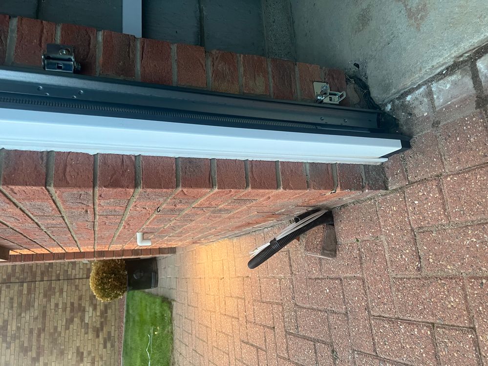

It's not clear from the picture how the ethernet cables get into either the house or the garage.
It's not in a conduit unfortunately so not really an option unfortunately. It's just tucked under the garage door frame corner. I can put new 20mm flexi conduit in though and bring it up at point B so they can then fit the outside box, drill through into the garage and the ONT can go on the other side of the wall. There's some internal trunking with plenty of room running from there to the other end of the garage where the UPS and router are if they're happy to fit it further into the garage.

Thanks for the pictures.
I don't really see any problem at the house end. Getting into the garage is another matter.

You don't show the garage end - as mentioned I don't know if the installer would be happy with the setup previously shown.
