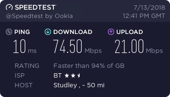

I see this on speedtest.net and TBB:
7467785725

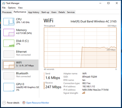

Here's me transferring a file to my laptop via wireless AC from my NAS - transfer speed is around 300Mbps so I would hope to see the 80 from your service. I'll go and try with an Ethernet cable though
ETA: Here's a wired speed test. I can pull 1Gbps from my NAS over this cable
7467811236

That's about the best speed you can get on 80/20 after allowing for the BT IP Profile and overheads. Fast WIFI and 1Gbps ethernet won't make it any better. Just enjoy the reliable FTTP connection.Smiley
Edit: Or have I got it wrong?  @Gandalf  Does the BT IP profile apply to FTTP connections?
