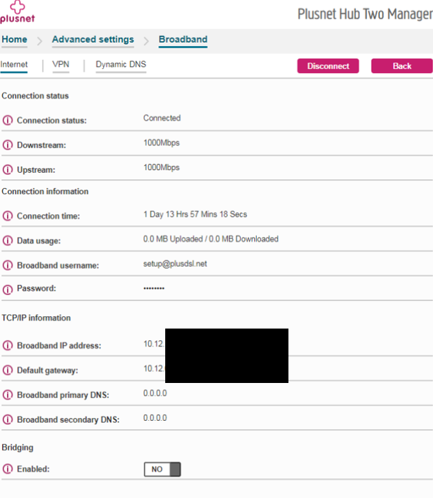

My service was activated a couple of days ago (moving into a new home), but we still aren't able to get internet.  The router (a Two) is showing a blue disk, and the control panel says broadband is connected, but any device I connect to the WiFi is saying there's no internet access.
According to the router's control page, our public IP and gateway are assigned, but the primary and secondary DNS are 0.0.0.0.  The username is still setup@plusdsl.net.  Since that was the cause in other old posts, I did try chaing the username to my accouunt @plusdsl.net and my password, but the behaviour was the same -- the router believes it is connected to broadband but there's no access to the outside world.  From a connected device I can ping the gatway address but anything else (e.g. 8.8.8.8) fails.  Since that didnt help, I factory reset the router and reset the ONS, but neither have made any difference.

Since the router didnt autoconfigure ( username remained as setup@plusdsl.net ) despite PN claiming that the account is activated, and changing the username manually didnt make any difference, I suspect that the BTwholesale circuit hasn't been built correctly. The connection isnt being routed to the Plusnet 'realm' , instead its terminating on the BTwholesale 'sandbox' realm. Hence the lack of DNS and internet access. We've seen one or two instances of this with FTTP and it seems to take some while to get it sorted. The problem is that everything looks ok from the Plusnet POV and so normal troubleshooting processes dont find the fault.

When you manually put the account details into the router, does it indicate that it is connected - that is do you get the external IP address, gateway and DNS servers assigned?  See here Basic - Status (from a device connected to the router).

With my account credentials as the user/pass, the Plusnet Hub status is:
Broadband IP address is populated with a 10.XXX.XXX.XXX IP.  Default gateway is also populated with a 10.XXX.XXX.XX IP.  Primary DNS is 0.0.0.0, and Secondary DNS is 0.0.0.0.
That's the same if I leave it on the setup@ credentials.
Yup, that more or less confirms the connection is getting terminated on the BTw realm.
when this is using a Plusnet supplied router which SHOULD autoconfigure, so its not a router configuration issue

@ClaudiaG23 since your advisor evidently won't be calling me tonight after all, I'll try and post more information.  Just to be clear, waiting until 6pm was only because PlusNet insisted I be next to the router in order to confirm that it was, in fact, plugged in correctly.  If what I have provided below is enough to escalate this, then I can discuss that at any time.
Please find below photos showing everything I've already described here:  The ONT is on, PON illuminated, and the connection is between ONT port 1 and the PlusNet Hub Two's WAN port.  The Hub is showing a blue light.  And as far as the hub is concerned it is connected to broadband, but without DNS assigned and, evidently, on a subnet that indicates it isn't being routed correclty by OpenReach (thank you @MisterW !).
If you still believe this is a configuration issue at this end, that it would be helpful to call at the scheduled time.
