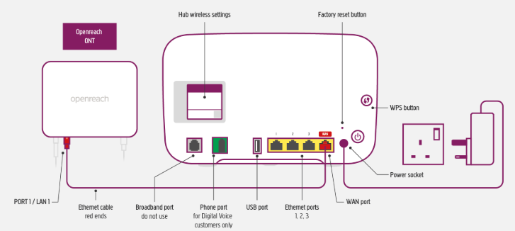

Posts: 4,975
Thanks: 3,279
Re: My router has broken
This might help with each and everything
