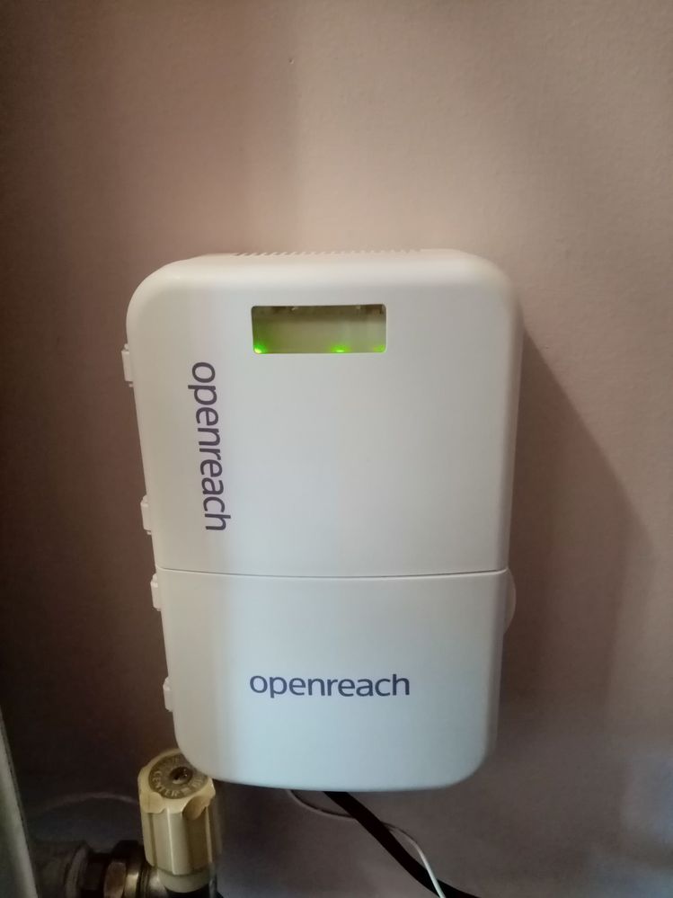

Just coming back here to update.
The Openreach guy wasn't telling porkies and just one box used in the FTTP install. No grey box outside either.
The fibre cable is connected directly into the ONT,
RobPN
Posts: 5,560
Thanks: 3,029
Fixes: 15
Registered: ‎17-05-2013
Re: FTTP install without grey box
@Bella123
So can we see a photo of the ONT then please?
Bella123
Posts: 74
Thanks: 5
Registered: ‎15-01-2025
The ONT is in the enclosure.

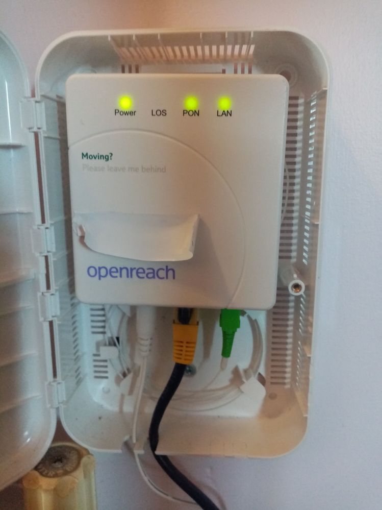

Posts: 5,882
Thanks: 2,195
Fixes: 117
@Bella123
Good to hear the install went OK. Is the ONT in your desired location?
Were the pictures taken before an etherent cable was connected for the router? I'm guessing the two cables shown are the incoming fibre cable and the power supply. Though having said that the incoming fibre could be behind the ONT itself.
Posts: 20,180
Thanks: 9,098
Fixes: 581
Not from what I can see. The black cable is the Ethernet. The fibre is the one pre-terminated with the green plug.
The excess fibre is coiled up, where it goes from the ONT is not obvious. All the visible fibre is internal type, so it must be spliced somewhere to the external fibre ?
RobPN
Posts: 5,560
Thanks: 3,029
Fixes: 15
Agreed @MisterW
I recall for a short period OR used a method without a CSP whereby the black outer sheath of the fixed length incoming (pre-plugged) cable was stripped back to reveal a white internal cable, but I didn't think that method was still used, so if it's not been done that way I wonder where the splice is?
Posts: 5,882
Thanks: 2,195
Fixes: 117
@MisterW
I'm thinking the incoming fibre is hidden by the ONT. It would have been stripped back to the fibre sheath at the wall and then fused to the pre-terminated Green Plug. The excess cable is then coiled up as can be seen in the pricture.
