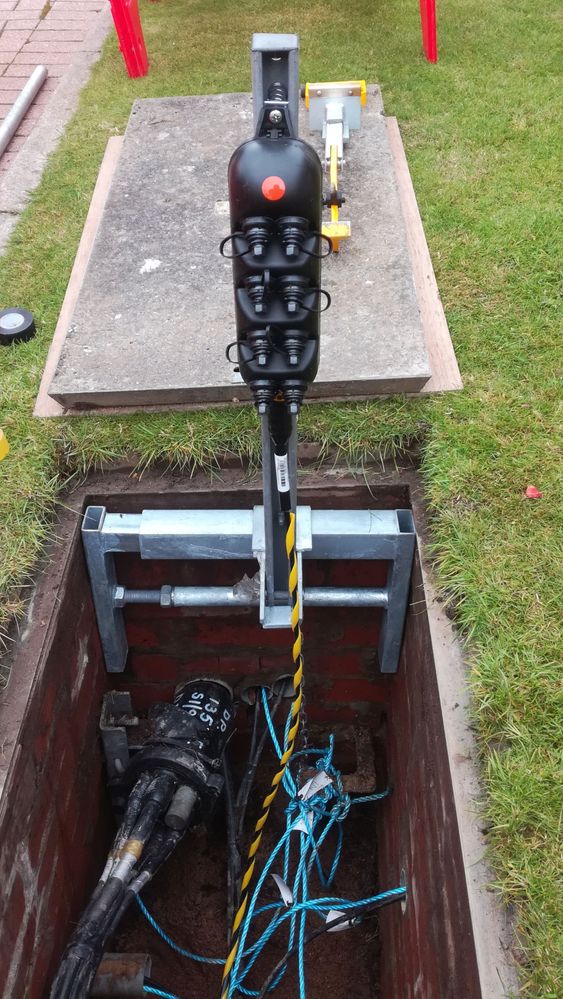

Re: FTTP install without grey box
@pvmb
This is the chamber for my house taken while the network install was in progress. The CBT is in place but no house connections made.
One length of blue rope goes up the street to the next chamber - not used in the end. The other ropes go to properties where the duct has been proven clear.
