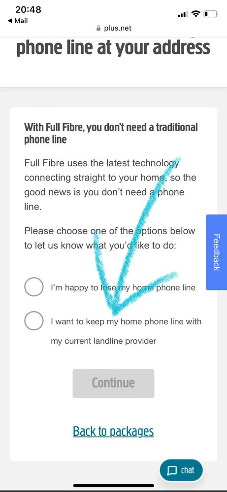

New installs get this option under “add extras”

Worth noting that on option 1 you are also effectively option 4 as this retain landline selection is available when signing up to full fibre.
