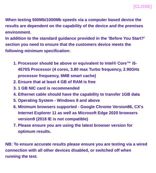

In contrast, I get a pretty consistent result using Ookla, irrespective of browser (900mbps product).
When you hit the higher throughputs there's a lot of other stuff that comes into play e.g. the capability of the device being used to run the speedtest. There will be older devices out there that simply aren't well specced enough to pull ~900mbps from a browser-based speedtest i.e. sub-par processor or disk/memory.
Not saying this is the cause in your case, but worthy of mention for anybody else that might read this thread.
There's a reason the Wholesale tester says things like this: -
