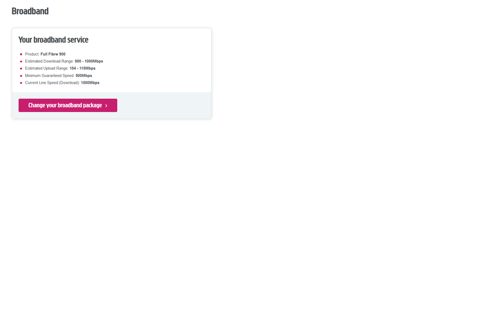

Problem not Fixed, no static ip address... my broadband service status is still Unlimited Fibre and Not Full Fibre which is now in place, will have to wait for Plusnet to update there end.

@mharvo from that image, it doesn't look like your account change has fully completed in the PN systems yet
It should say something like below but saying Full Fibre 500
