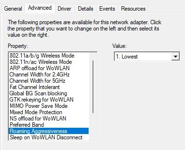

There are three basic roaming aggressive levels, the default is Medium. Network Properties might have five settings.
Lowest (1) Device will stick to the current AP until the signal quality is very poor or connection degrades significantly.
Medium (3) The default, balanced setting. The device roams only when necessary for performance.
Highest (5) Device actively and continuously tracks link quality and tries to find and roam to a better AP even when the current signal is still good.
The suggestion to set "Roaming Aggressiveness" to lowest with the "Preferred Band" set to 5GHz is an attempt to prevent the wireless connection switch to 2.4GHz in the first place.
There is always a but, I have found shutting the lid on my HP laptop it switches back to 2.4GHz which odd as the preferred setting is 5GHz, perhaps something to do with power saving.
For me I notice a slowness when connected to 2.4GHz over 5GHz.

@Dan_the_Van wrote:
Having suffering from the same issue where my HP laptop keeps settling on 2.4GHz rather than 5GHz I've done some further research.
Regardless of the setting setting to "Preferred Band - Prefer 5GHz" I am still occasionally connect to 2.4GHz on first switch on. There is another setting to try
The better way of switching off a radio frequency in a client machine is change the two wireless modes which are at the top of that options list. Change that to 5ghz only and that means you stop the 2.4ghz radio from wroking.
As the 7265 card doesn't support mimo and despite it being a 2x2 desgin, i don't know if that would mean needing different aerials in the laptop if you upgraded to an ax card for instance.
