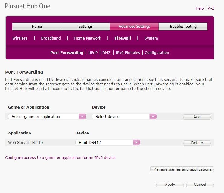

Can you connect to the website within you local network?
Posting a screen shot of the router config might be useful too.

Re: New Static IP address seems to be blocked and PlusNet Helpdesk are unable to help!
16-03-2022 9:57 PM
I can connect to the website internally - Yes.
The synology does have a static IP.
Can you expand on what you want to see from the Router config please?
16-03-2022 9:58 PM
16-03-2022 10:00 PM
