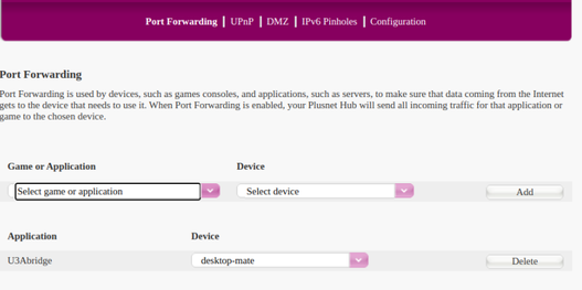

One the Hub One Advanced Settings >Firewall >Port Forwarding do you see something like
In my example I have used a hostname which is best as sometime the device IP Address might change which will stop the port forwarding.
