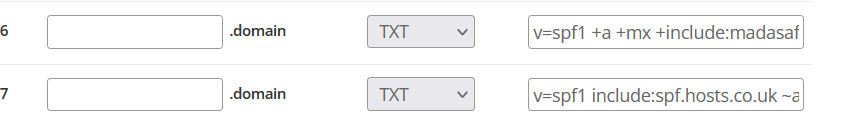

Thanks. I currently have two records:
I currently send emails through the Plusnet SMPT server and download them from my domain email platform, Namesco (a.k.a hosts). Do I need to delete both records and just add the Plusnet one?

I didnt think you could have > 1 SPF record
The spf record only relates to sending mail. So if you ONLY send via the plusnet relay , then you just need the spf record to define that. My example above should be fine.

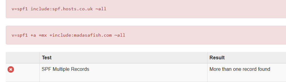

Is there an easy way of checking whether I have an active SPF record.  https://mxtoolbox.com/spf.aspx

I reckon that you are correct. I get:
I'm a bit chicken about changing things as I currently have no problems. Presumably I am just getting away with it at present.

I suspect you may be getting away with it at the moment by it having no affect.  I think most mail servers would probably error on finding multiple records, and so ignore all SPF checks, so having multiple may in effect be the same as having none.

If you do have two separate SPF TXT record entries, your emails will fail SPF authentication and return a PermError.
@Baldrick1 you really need to fix it.
If you wish to cover all bases then a single record of
v=spf1 a mx include:_spf-internal .plus.net include:_spf-internal2 .plus.net include:spf.hosts.co.uk ~all
should do it
