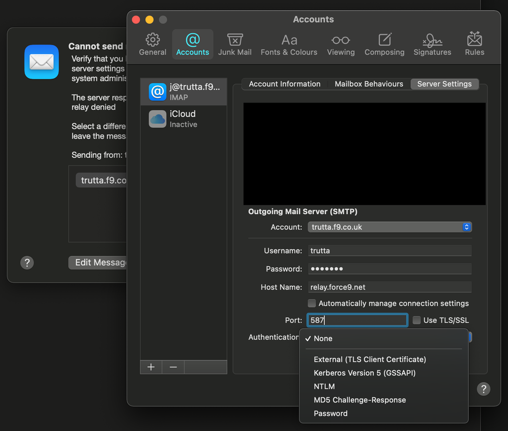

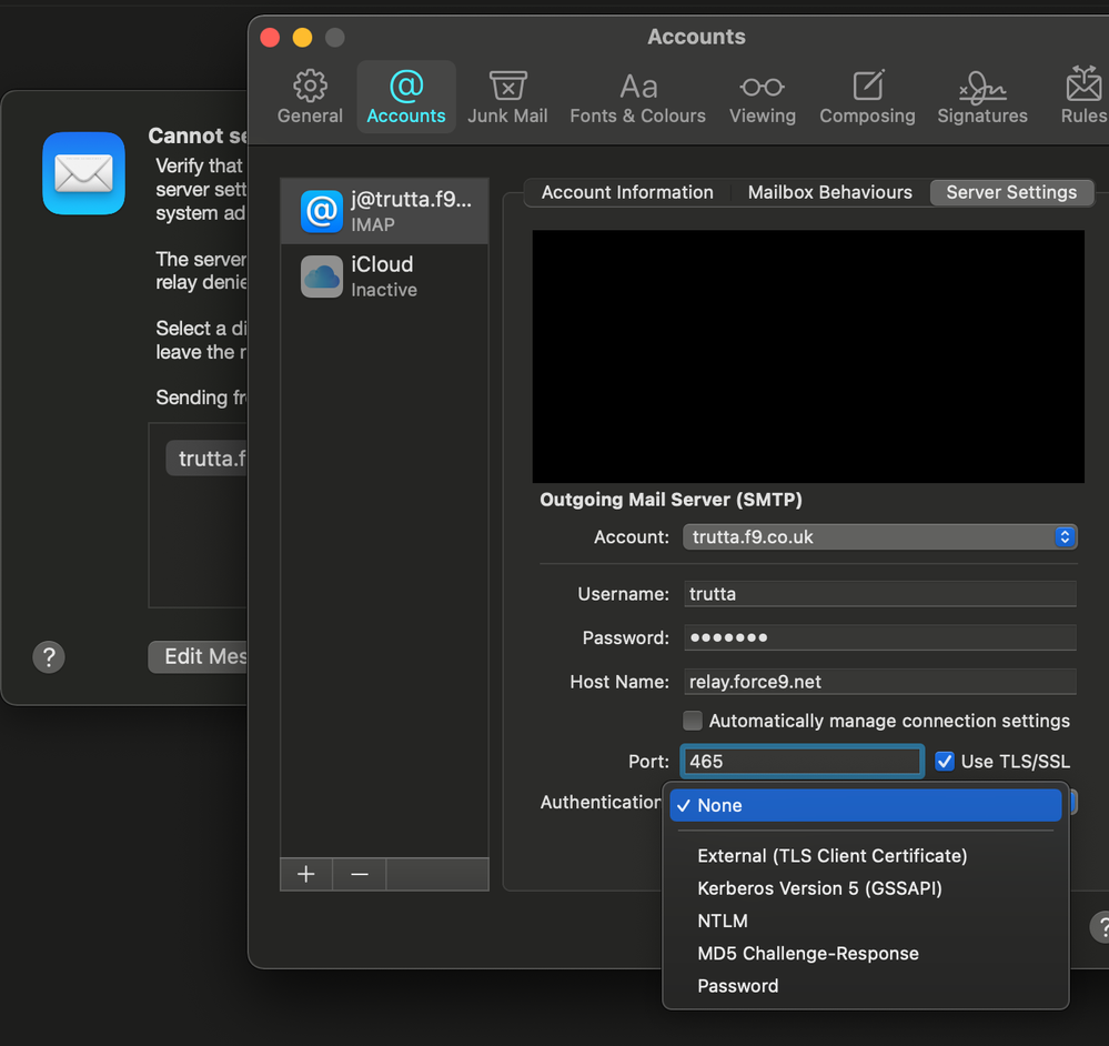

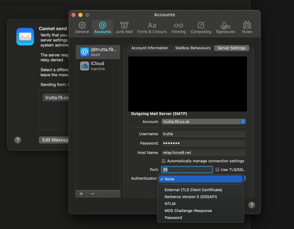

Here are some screenshots with my interpretation of Gandalf's suggestions, so far I haven't had any success.

One of the last two should work, but In both cases you will need to set authentication as 'password'
