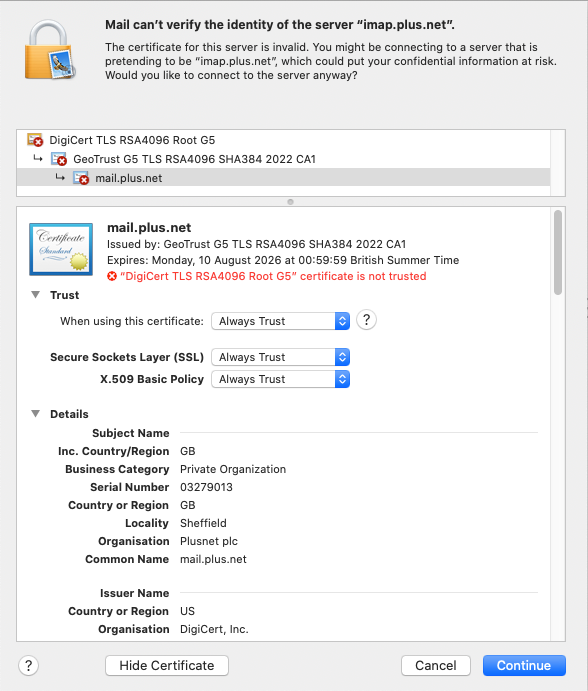

@Townman wrote:
@gareththered wrote:
Alternatively, you can (or may have to) wait for PlusNet to get their act together.
Can you please explain this statement?
I would expect PlusNet to get their act together and install the cross-signed certificates provided by DigiCert. What else?
The current chain, as presented by their servers, ends in the GeoTrust G5 TLS RSA4096 SHA384 2022 CA1, which is not signed by any of the trust anchors in older devices. The cross-signed certificate is the link between the above and an already installed root in those older devices. The cross-signed certificate needs to be added to their server chain, that's all.
In PlusNet's defence they're only following the CA/B Forum policy and moving to siloed roots, but there's a way transition smoothly, and a way to screw it up...
Let's Encrypt had egg on their face from a similar CA change a few years ago - you'd think the industry would learn by their mistakes.

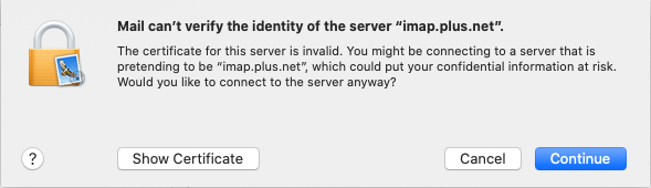

I'm getting the same message on my Macbook running macOS 10.15.7 (Catalina) and Apple Mail client.
I'm not currently seeing the same message on my iPad, running iOS 18.6 (up-to-date).
The Mac was running fine last week, it's only just started since Monday this week, same as others have reported.
Any ideas?

My take on the G5 Root certificate. See the quote from the link provided by @j123 in post #75
"However, even once the roots have been added to the trust stores, you can’t guarantee that users will immediately update their systems, browsers, or applications to the latest versions. To ensure your certificates are trusted even when the new G5 root is missing from a needed trust store, DigiCert recommends installing a DigiCert G5 cross-signed root CA certificate."
My bold added to quote.
I don't quite understand the point of view with regards to somehow adding this cross-signed certificate lowers or breaks security standards, unless the older root certificates have been compromised (no signs that this has happened as of yet). The newer PlusNet certificate is the main one controlling security and that does not change by adding the cross-signed G5 to it.
It is a simple choice as to whether to add said certificate or not:
- Don't add and expect many customers complaining with lots of confusion - increased workload for phone call centre - breaks connectivity for all device that have not received trust store updates that include the DigiCert G5 root CA.
- Add and forget - job done.
I know what I would choose, path of lease resistance.

You need to either add the G5 root certificate to you Macbook, or wait until PlusNet add the cross-signed certificate to their mail servers.

Please share how you achieved this on your iphone.
I downloaded the certificate as flagged by j123 onto my iPhone. It came up as a message in Settings somewhere (I didn't notice where, but it was obvious). I opened this, which gave me the option to verify. This I did, and then then went to Settings/General/About/Certificate Trust Settings and enabled the new certificate.
Sorry if this seems a little vague, but I was floundering around not having a clue what I was doing. It worked, however, and I wish you good luck in your attempt.
