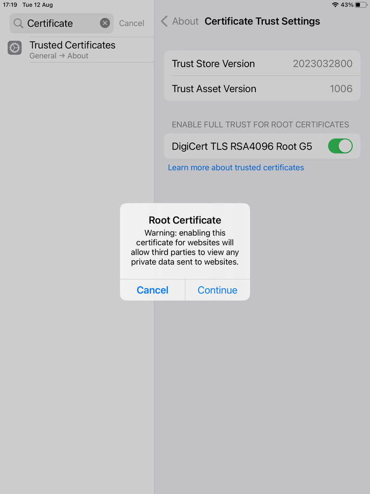

IMG_3195.pngThank Thank you very much j123, truly a "rising star".     Should I be worried about the above?
For the record;
Macbook email was not working.  It was a couple of updates behind but once I updated to MacOS Sequoia 15.6 it worked.
iPhone 12 mini - no problems.
iPad (5th Generation)  email not working, used j123 fix.
