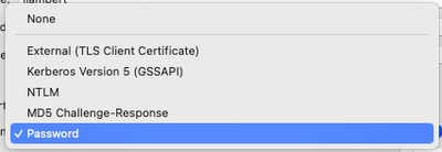

Thanks for the response, I'm using 'mail' with iOS and macOS...this is what I've had as my settings forever!

Those environments normally enforce authentication...
iPhone...
  1. Settings
  2. Mail
  3. Accounts
  4. Select relevant account
  5. Select Account
  6. Select SMTP
  7. Select PRIMARY SERVER
    1. Server should be enabled
    2. Host Name - relay.plus.net
    3. Username - accountname or accountname+mailboxname
    4. Password - that applicable to the above
    5. Use SSL - enabled
    6. Authentication - password
    7. Port - 587
  8. Click DONE - account should be verified successfully
  9. Click back to account
  10. Click DONE
macOS should be similar.

Thanks,
See screenshots in thread above, have double checked all...I think that looks right.
Only bounces from gmail...still doing it...
