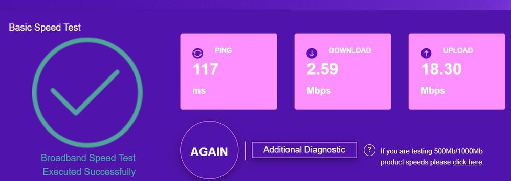

I have had good results from being with Plusnet.. router was being restarted manty times per month with TalkTalk.
Today though YT buffering a lot.. restarted router. router claims 65.8Mbp downstream sync and 20 upload. I tried the BT test from the router
and got this just now..
Don't know what can be done.. wait a bit and see if it improves?
It is 'usable' thankfully as you can see...

after clutching at straws for a bit I decided to switch off my BT 1Gb powerline ethernet adapter/device to my room and after 30 seconds waiting..
instantly got 60mbps download and 18mbps upload..
not complaining but never noticed this before as a potential problem... I always turn off the powerline adapter overnight. Something for me to remember to try in future. Phew!

Some Ethernet over Power adaptors do play havoc with VDSL performance, especially the budget ones. Devolo adapters have interference cancelation settings.

There are two somewhat different considerations...
- Line sync speed - which is not overly affected by the presence of power line adapters
- Error free data transfer speed - which can be impacted by interference from power line adapters
Local interference might not impact the line speed, but might give rise to high error retransmission rates, thereby having a marked impact on data throughput rates.
Which router are you using? If the Plusnet Hub One, that is a BTHH5a for which there is a custom version of router stats - see below. It would be interesting to run that and examine the SNRM plot with and without your power line adapters operating.
Sight of the router stats would be informative (with and without the adapters being powered up).
