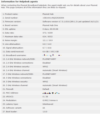

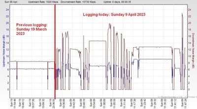

Here we go again. For the third time since last October 2022 my Broadband unlimited service is in a state of being constantly interrupted. When the connection is up the noise margins are very poor. Does anyone have any suggestions or is it another complaint to plusnet? I've tried the Quiet Line test and that is noise free.
I append plots from RouterStatsHub and from the Plusnet Hub One Helpdesk display:

@simonc2 Your 'guess' is totally wrong. Looking at the data presented, your connection is suffering from (and has been for a while) some form of issue on the BT/OR network. I would suggest you immediately raise a BROADBAND fault via https://www.plus.net/help/report-a-problem/broadband/ but be aware that this is a long Bank Holiday weekend, so it possibly won't be picked up until  next Tuesday.

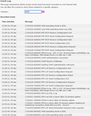

Here are the most recent entries. Let me know if you want older entries.

The router has been up for coming up to 6 hours now, but the downstream noise margin is 12.1dB which is much higher than it was when I last monitored the connection (19 March 2023).

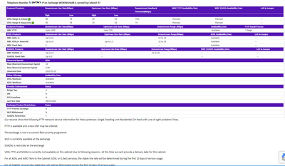

Simon - can you post a screenshot of the result from here: https://www.broadbandchecker.btwholesale.com/#/ADSL -obscuring your phone number.

Last few lines wouldn't fit in the screen grab. Let me know if you want them as well.

No need for the rest of the BTw report Simon. What you have posted though is interesting - you have FTTP available, but FTTC is 'planned'. That is an unusual scenario - wonder if @Dan_the_Van could throw any light on this?
Your full Event Log is interesting - it clearly shows faults in the BT/OR network to me, but I am open to correction if anyone wishes to disagree.
