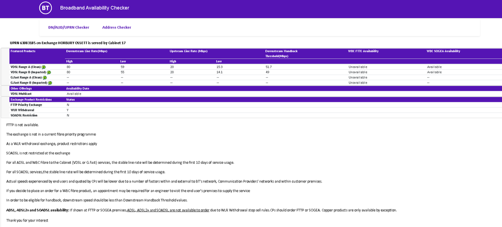

Hmmm, another line fault?  Had OR out twice for 4 different faults.  Given I'm 200m from the Cab it's frustrating to say the least.

Re: Throttling?
@PantherEins
The only time that Openreach ‘throttle’ a connection is if after a reset there are two many errors on the line and data is having to be resent too many times. This is an automatic DLM action designed to increase the useable data that you receive.
It is unusual for your service to be reset due to a contact renewal but could result from a change, for example, a move to SOGEA.
I don’t know if it’s relevant but in the early 1970s the GPO, as it was then, used aluminium cored cable rather than copper for some installations. This has always been troublesome.’
Either way, your speed is below the handback threshold so you should report a fault.
