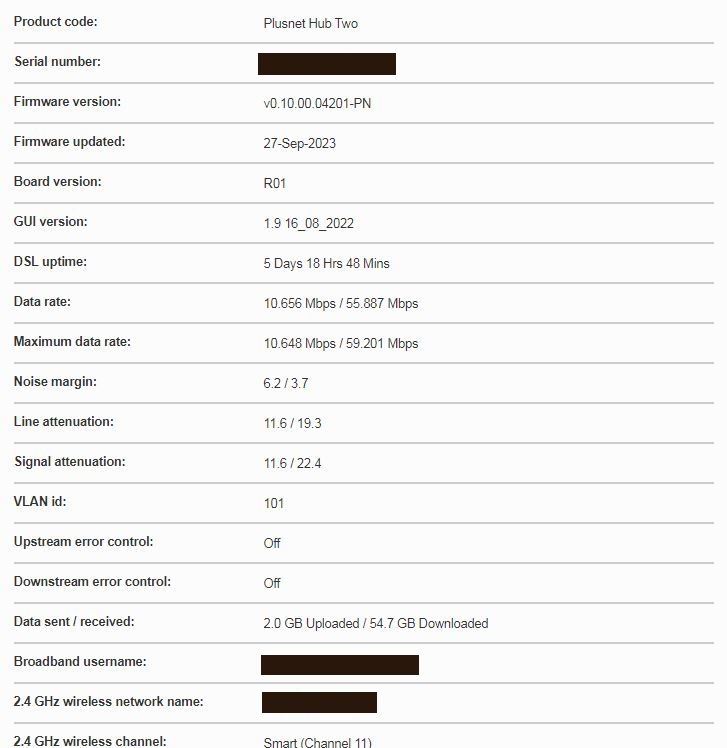

Re: Slower broadband speeds
Well, you've had no drops, according to that, since your refresh, and the fact that your downstream SNR is still lower than I would expect for your line length, suggests you have good line.
All I can suggest is that you do what I used to when on FTTC, and check that once a day. If the DSL Uptime drops again, repost, but as it stands I don't think there is anything we can do.

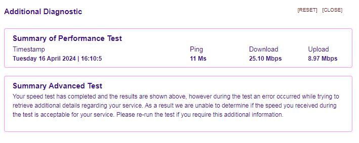

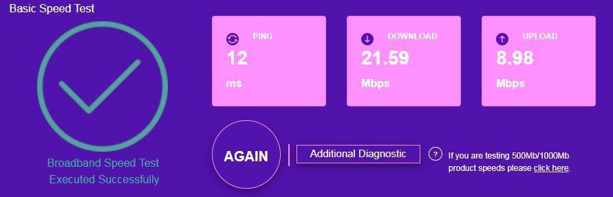

I've been keeping an eye on my speeds but just checked and it's down to about 24-26 Mbps (using https://speedtest.btwholesale.com/details). Is there anything that can be done or is it time to get an engineer involved.
Please let me know if you require any more info' tests.

Looking at the Technical Log you have had a couple of drops quite close together this afternoon, and it looks like the DLM has upped your D/S noise margin quite aggressively, presumably in an attempt to stabilise things, so that suggests you have a problem somewhere. Is it possible to select the 'Event Log' on there and then 'Export'. Once you have done that, attach the resulting, file to a new post please.
