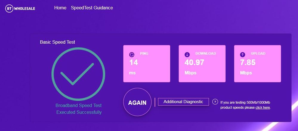

@PabloBruno You keep asking this, or variations on it, every so often - people attempt to help you, but you seem reluctant to follow the advice/help offered. Assuming you are on FTTC, can you please reply to the below, and maybe some of us could advise?
BTW Performance Tester - Over a wired (Ethernet) connection if at all possible, please report the 'ADDITIONAL DIAGNOSTICS'. This test is recommended to be performed with only one device connected.

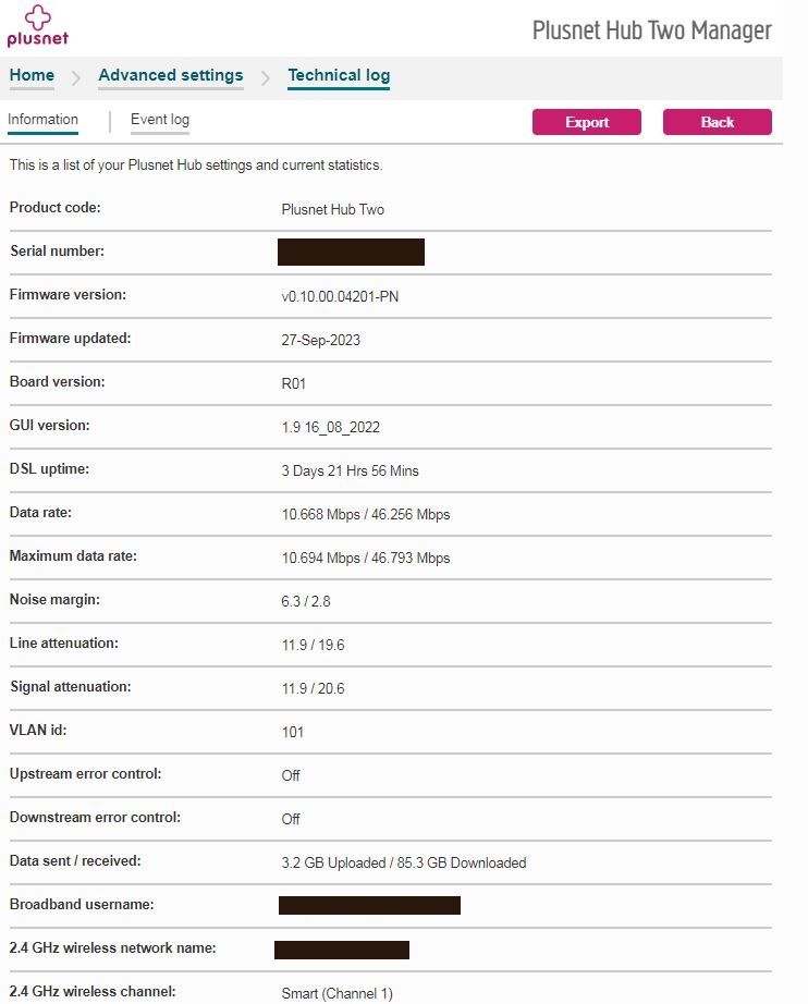

I think I have always accepted their advice as I am desperate for a long-term, stable connection. Here are all the screenshots you requested.
I have no phone and never use the landline so cannot carry out the other tests.
Re: Slower broadband speeds
27-03-2024 6:37 PM

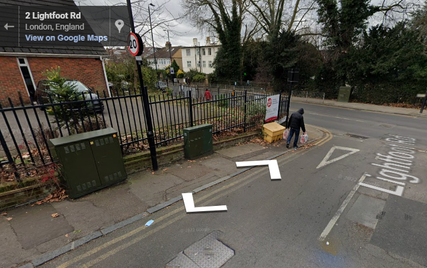

Thanks for this.It appears from that information that you are/have been suffering from xDSL drops, which will account for the reduced speeds experienced. I also note your downstream SNR is very low. How far are you from your VDSL cabinet?
27-03-2024 6:57 PM
I'm afraid to say that I have no idea where the Crouch End VDSL cabinet 10 is.
27-03-2024 7:00 PM
Do you know where your nearest cab is? - that is usually the one you are connected to.
27-03-2024 7:04 PM
As I say, no idea I'm afraid.
27-03-2024 7:09 PM
Do you not notice them when out and about - they are big and green?
27-03-2024 7:19 PM
I would look here
HTH
27-03-2024 7:35 PM
No. I have lived here 5 years and have not seen one. Hence, that is why I said I did not know where it is.
If it is Lightfoot Road, then that is half a mile away and a ten minute long walk to an area I usually don't go to.

That distance sounds about right for the data in the BTw report earlier.
