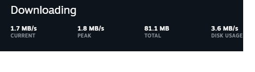

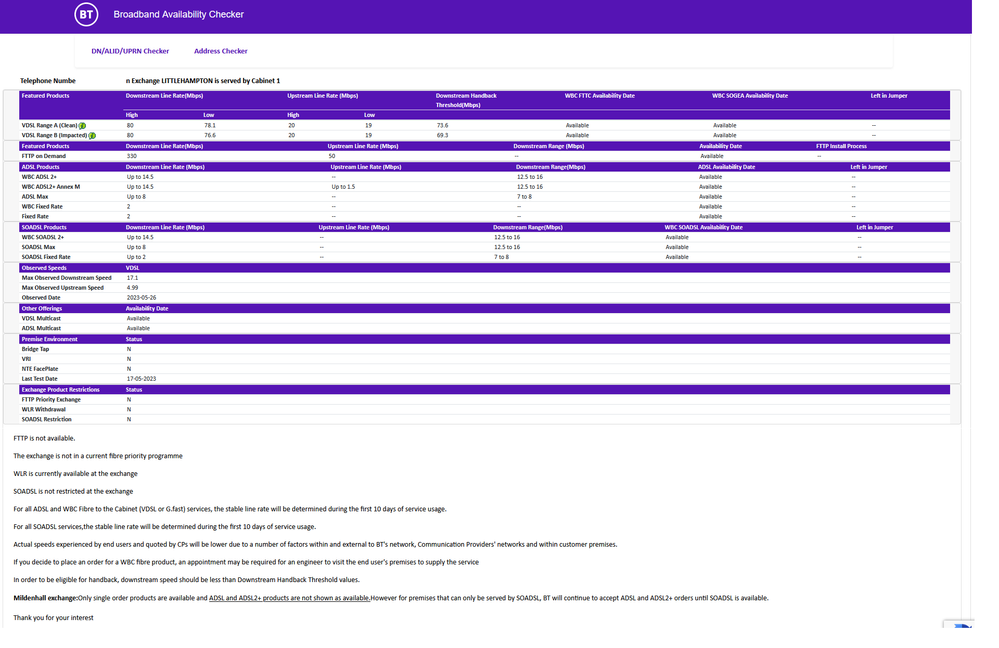

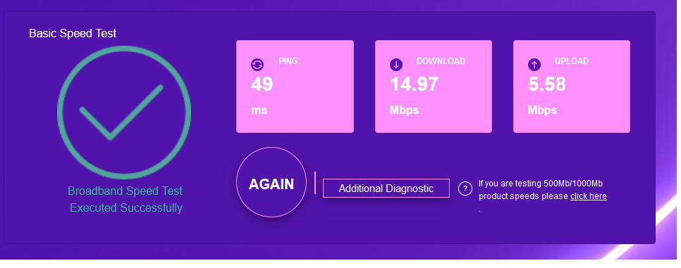

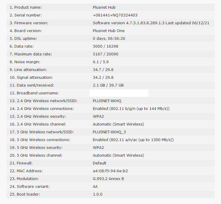

BT BroadbandBT BroadbandBTW TestBTW TestActual download speedsActual download speeds
Router infoRouter info
Top image is the BT Broadband link, second image is BTW Tester and third image is the actual download speeds I am getting when downloading an example 3gb file in Steam. It's worth noting that I last ran a speed test using Google's inbuilt speed tester and I was getting figures in the low MB, this was on Friday, so seeing nearly 15mbs is a bit of a surprise and not an accurate reflection of our actual download speeds. Let me know if anything further is required.

@Ferrush I can see the images in your profile. The Helpdesk shot is the useful one - it suggests you are having xDSL drops which strongly suggests a BT/OR network issue, unless you have turned the Hub off for any reason? The other interesting data on there suggests you have downloaded a massive amount of data in the six hours the Hub has been up - do you have anything like Microsoft OneDrive running? If so this will massively impact your throughput.

Thanks for your help. The large amount of data may or may not have been a member of the family downloading programs through Sky... Which is confusing because on Friday I was getting 1mb download speeds on a 12gb file and took a couple of hours to download, I also have massive issues accessing network files whilst working from home (when Sky on Demand/streaming isn't an issue) but streaming services and the Sky on Demand services don't appear to be impacted as this can be done comfortably (almost like the laptops have been given a lower priority connection). As for OneDrive I am aware this is active on a family members phone and laptop, but expect use of this to be light.

You need to watch your MB and Mb.
Broadband speed tests and the router syncing are quoted in Mbps ( Mega bites per second) where downloads are usually quoted using MB/s or MBps (Mega Bytes per second)
So a download speed of 1.7 MBps  (MB/s) equates to 13.6 Mbps (Mb/s) which is close to the current router sync speed

As @jab1 states, you need to ensure that there is no other background traffic when doing a speed test. It must also be conducted over a directly wired Ethernet cable between your router and the testing computer.
I also note that your speed test is reporting in MB/s, note the capital B, which means Bytes. The hub stats report the speed in b/s, which means bits. There are 8 bits in a Byte so whilst this speed is way short of your estimated speed it is maybe 8 times faster than you realise.

Looking again  at the information you have provided, I suspect there is more going off somewhere, but I can't put my finger on it. Your connection speed is a little low, but not massively so - you are obviously a distance away from your Fibre box, so will never get great speeds.
I'm no great expert on OneDrive - never having used it - but if it is active, it will still be having an effect - AIUI.
Until we can rule out a phone issue, there is little more I can suggest, but I am still a little concerned over you low uptime. Is it possible to post the output from the WAN tab of your Hubs Event log, please?
