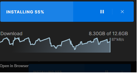

Thanks @Baldrick1, I imagine I am not the first person to get confused between MB and Mb/s :-). To confirm, the download on Friday was 12.6GB in total, and I was regularly getting speeds of under 1Mb/s (luckily I took a screenshot). Fridays Download Speed.png

How have you concluded this? It is dropping but are you aware that the 871kB/s is, as explained earlier, just under 7Mb/s.
The fault reporting bot is currently active, if you use that it will be interesting to learn of their response.
The other thing to realise is that when downloading you can’t receive data any faster than the other end is sending it to you.

As an aside to @Baldrick1 's comment above, it is not just your download speed that affects the time taken, but also the capabilities of/load on the server at the other end.
