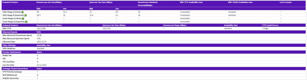

This is a screenshot of the BT broadband checker...

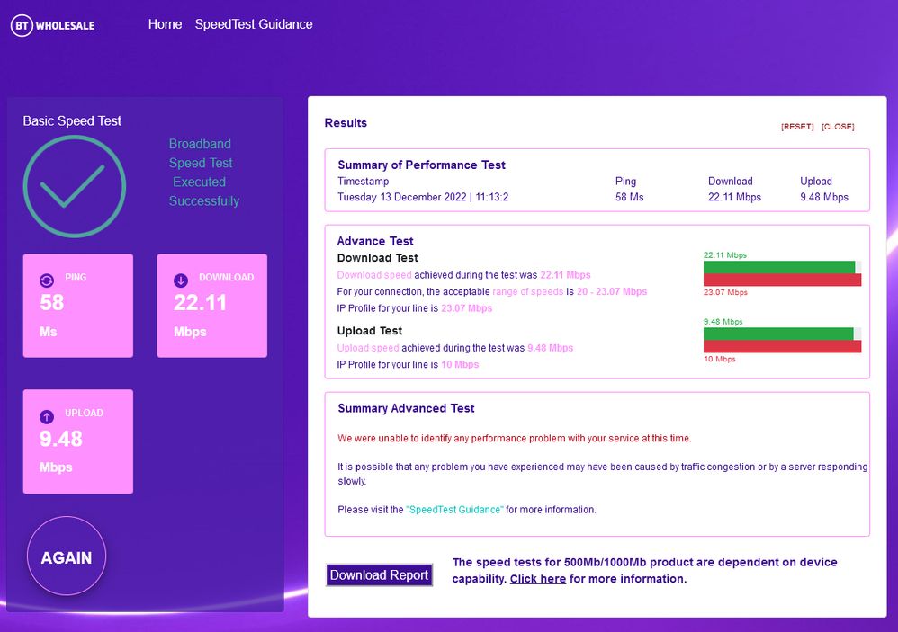

...and the speed test result with the router connected to the test socket of the master socket.The download report button wasn't working for me.

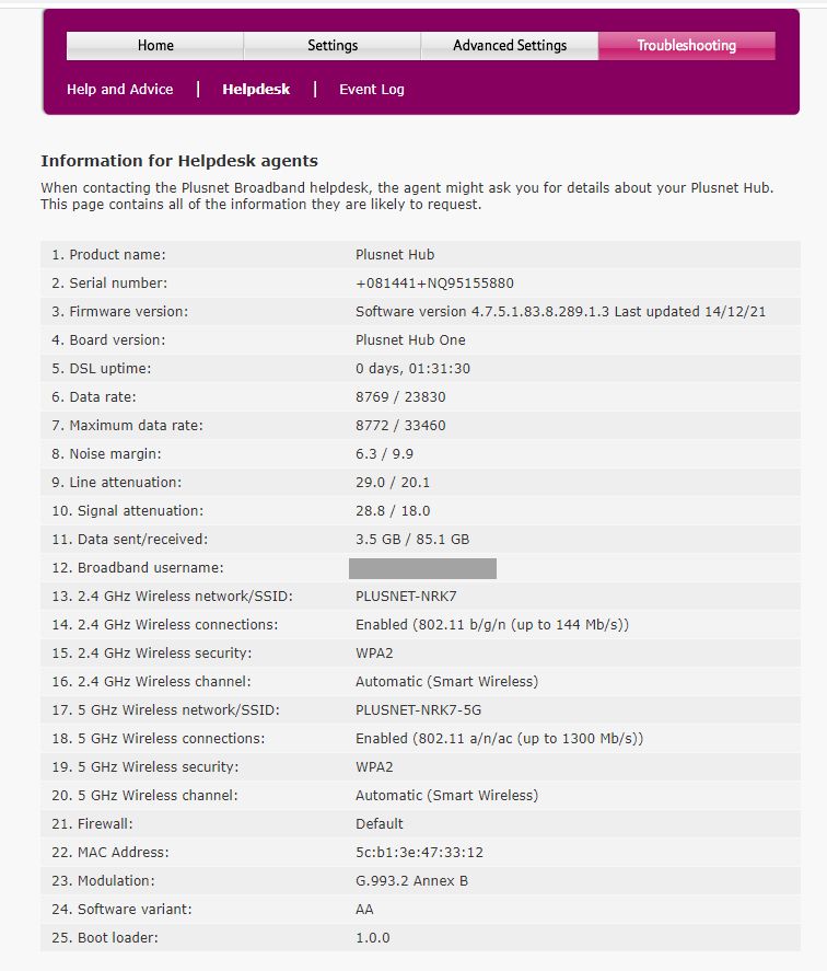

@Bren88 Which Hub are you using?
The
sight of the broadband connection status from your Hub (with the 'Username' obscured) would help here.
For the Hub One -
For the Hub Two -

@jab1  The router is a Hub One.

@Bren88 Thanks for that info.I suspect a BT/OR network issue, or possibly a phone fault - your DSL uptime is extremely low, and the D/S SNR higher than it should be. The WAN tab of your Hubs Event log would confirm my suspicions, but don't worry about it.
It sounds very much like you have a problem - most likely not in your home/office environment, but more likely in the BT/OR network.
If the phone test passes, report a broadband problem via: https://www.plus.net/help/report-a-problem/broadband/

Could the low DSL uptime be due to me disconnecting the router earlier today to test it at the master socket?
Doing the line test there is a very feint hum (I wonder if that could actually be the phone itself though. It is corded) and an occasional click that I can hardly hear roughly every 5 or 6 seconds.

@Bren88 That would account for the short uptime, but as I said, there is a BT/OR network problem - use the 'broadband' link I provided above - it may be a phone fault, but I doubt it from your description, and in any case if an engineer is required, they should check your phone connection anyway.
