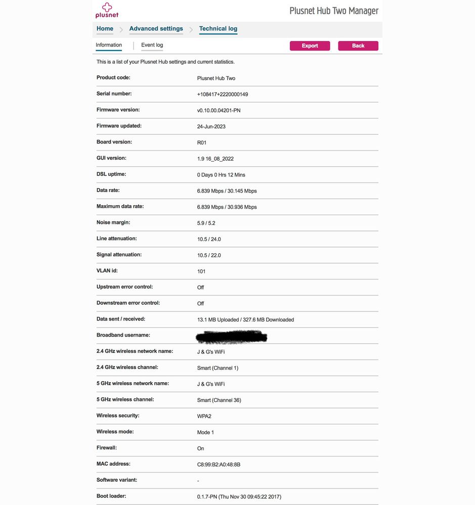

Sorry for the late reply, it’s been a hectic day. Thanks to everyone for the suggestions too. Here is a screenshot of the technical log. Timing is great as the router just reconnected again.

@82sg Looking at that Technical log, I am convinced there is a fault somewhere, despite PN's denials. Your line attenuation suggests you should be getting around 60/65Mb/s connection speed, your SNR margins are not indicating any issues, and yet you are restricted to about half what I would expect you to be getting.
I appreciate it is a pain, but can you give us a another export of your error log, please?
I'm intrigued why you would conclude that ?, my estimate would be nearer 42Mb if it wasn't capped at 40Mb.
The latest log file suggests to me that there is an intermittent external line fault somewhere,
as the connection seems to toggle between 32Mb and 40Mb, with no pattern related to time, or SNRM.
Hopefully the engineer will find something !

At the risk of being lectured (not by you) over the years looking at Hub event logs I came up line attenuation against Maximum data rate matrix
Typica Line attenuation to Maximum data rate
0.7 Km from cabinet Maximum Data rate 35,000 Mbps; line attenuation 21.9
0.6 Km from cabinet Maximum Data rate 44,450 Mbps; line attenuation 19.1
0.5 Km from cabinet Maximum Data rate 50,415 Mbps; Line Attenuation 15.7
0.3 Km from cabinet Maximum Data rate 89.472 Mbps; line attenuation 11.6
This is for guidance only, no way set in stone as many factors can change Line Attenuation.
As we know https://www.broadbandchecker.btwholesale.com/#/ADSL would be the best indicator of expected speeds
@82sg
Looking at the event log you posted there is a device with MAC Address 80:91:33:E5:13:F7 which is repeatedly trying to connect using your WiFi. I doubt it is the cause of your issue but not helpful for your LAN performance.
MAC Address 80:91:33:E5:13:F7 lookup comes up with AzureWave Technology Inc. If that helps identify the device.
It is likely a wireless password issue.
Do you use your Landline Phone? Are there any redundant phone extensions around the property as internal extension cable can add to the Line attenuation resulting in slow speeds

@Dan_the_Van Thanks for that data. I can't really comment, as I moved from PN ADSL (with an attenuation of ~39) and speed of around 12Mbps, to FTTC with Zen, whose 7530 Hub, at least in its default configuration, didn't quote attenuation figures, merely estimated copper lengths, and at around 400m, said I should expect a  max of around 60Mbps.
It would possibly be useful if the OP could give us an estimate of his 'last mile' length?
Posts: 5,042
Thanks: 3,329
Re: Router connection dropouts
@jab1
Must not forget ADSL line attenuation would be to the exchange, VDSL would be to the cabinet.
Yes it would be helpful to know the last mile length
Me - 0.3 Km from cabinet Maximum Data rate 89.472 Mbps; line attenuation 11.6
Looking at Speed against distance from the cabinet 60Mbps / 400m looks like you received the expected speed.

An openreach engineer came out this morning and ran some tests, disappeared to the cabinet for a while and came back to say that the tests showed a lot of errors on the line. He then said that we’ve been switched to another line. So far, the connection has been up for about 9 hours without interruption, which is a good start, and the speed is back up to 40/6 mbps which is what it used to be before all this started. Hopefully this will be it all sorted, and I’d like to thank you all again for taking the time to help me get this sorted. I really appreciate it.
