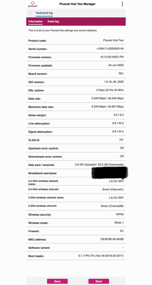

Can you post a screenshot of your router stats, so we can compare with those in Reply #18
It would also be a snapshot in time, that you can refer back to, if you were to have problems in future.

Good idea, thanks.  Here’s the latest technical log.

@82sg Those stats look MUCH better, but you appear to be hammering your connection if that data sent/received is correct. 😉

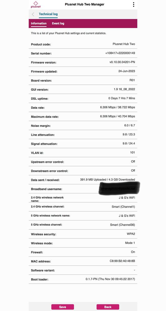

So far the network has disconnected once, but not sure if that would be something to expect after what was done on Thursday as it’s lasted longer than it used to. I took some screenshots of the technical log through the day in case anybody can see anything that looks to be a problem. I think the only thing that’s changed throughout that time is the noise margin, but again, I’m not sure if that’s normal.

@82sg Keep your eyes on the 'uptime' - the disconnections could just be the system training itself. Roughly when was the last screenshot, with the slightly higher SNR, taken?

In the first ten days after a line reset, if you see the occasional re-sync between midnight and dawn then it is likely Openreach DLM trying to optimise your connection, if the disconnections happen outside this time window then perhaps keep a record of when they occur - in case that reveals a pattern that might help with any future diagnosis.
@82sg wrote:
I took some screenshots of the technical log through the day in case anybody can see anything ...
When you are posting those technical log screenshots,  can you type in next to each the time and date of the snapshot
so that we can see whether there is any pattern emerging of say the SNRM varying with time of day, etc.

Thank you both, I’ll keep an eye on it and if I post anymore screenshots I’ll add the time taken 👍
