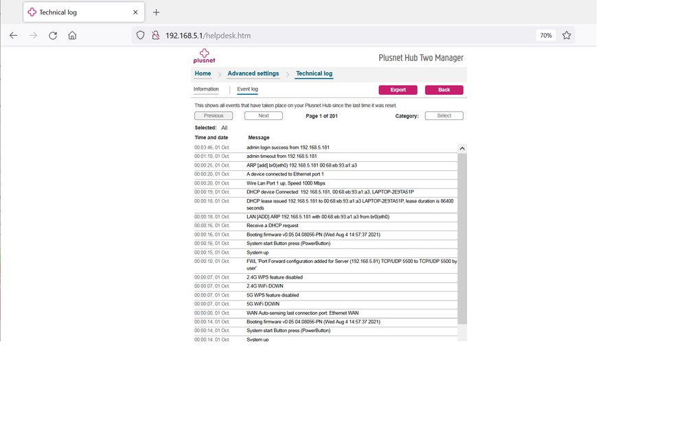

Assuming you have a Hub2, can you please attach the error log to a post - navigate to the page in the screen shot below, and click the 'export' button.

Thanks for the suggestions, unfortunately I can’t reach the BT test site, it appears to be down. The hub light changes to orange I believe. I’ve attached the error log as requested.

@82sg Thanks for the event log. From that, I think it is safe to say you are having too many DSL drops for it to be claimed you are 'running normally'. Personally, I would go back to PN and ask them to carry out some more checks. I appreciate you have said previously that you have done reboots/checked cabling etc, which obviously will give rise to some of the drops, but very recent behaviour still suggests there is something not quite right.
Before you do go back to PN, though, can you post your 'Technical Log - Information' screen, so we can see your connection status -  obscure your user name in it.
