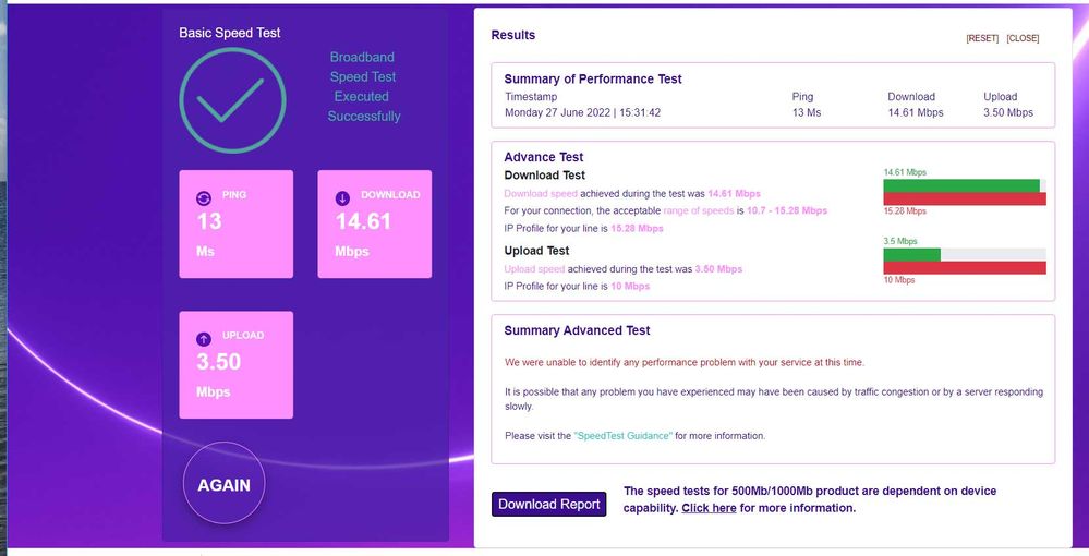

The first thing to try is the basic BT Speed Test to see if it speeds up at all.

via ethernetvia ethernet

@smallblueplanet So no discernable difference in the two testing regimes? I suggest, if you haven't already, that you report a broadband issue, via the link I posted earlier.
