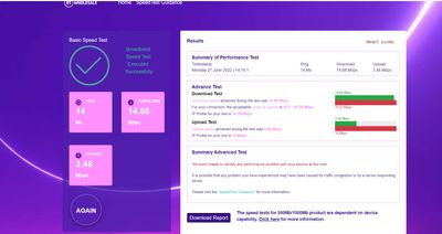

So I thought I'd check into my Plusnet account and see if there were any status issues - none showing. So I thought I'd try the BT speedtest.
When I put my phone number in it gave this:
"Advance Test
Download Test
Download speed achieved during the test was 14.66 Mbps
For your connection, the acceptable range of speeds is 10.7 - 15.28 Mbps
IP Profile for your line is 15.28 Mbps"
However my account (now, and when I joined) shows the download speed as:
Estimated download speed: 18 - 27Mbps
Has something changed as the speeds have been poor at times over the past few days(?), down to a standstill? And my IP Profile was not previously that low.

Don't get snotty. I wasn't sure how to upload a screenshot - as you see I've not managed properly.
Help or don't.

With respect I'm not 'getting snotty' but your response suggested that you didn't want Community help. Thanks for that first picture - it does show there is an issue somewhere, but without the rest of the requested information, not where it is.

BTTest-27-06-22.jpgAgain, I'm not finding uploading 'screenshots' straightforward.
As for the other test, there is no problems and I'm plugged into a Mk4 5C master socket. I've lived here some time during which nearly every piece of 'equipment' between the pole and our house has been replaced! We're running on old copper wires with FTTC.

Thanks again - that speed test confirms what you are getting is in line with your PN profile, but that profile is restricted for some reason.
What other test - the phone? So it is silent when you run the Quiet Line Test?

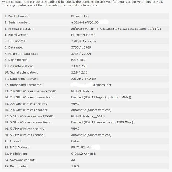

So I don't understand which info from Hub 1 you want @jab1

'For the Hub One -
Navigate from the Home Screen to Troubleshooting > Helpdesk' - if you follow this line of my post, you will see your 'Helpdesk' page - that is what I/we need.
There’s a wealth of info that can give an indication as to what’s happening. For example:
Up time
Sync Speed
SNR
Line Attenuation
Line speed
etc.
You are obviously a fair distance from your local FTTC cabinet and there many potential causes. This slow down might be  caused by the DLM trying to compensate for whatever it is that caused your intermittent slow speed. This can be a nightmare to find.
