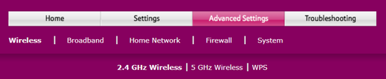

@Ennyoueffsea
For the Hub One you can see which wireless channels are being used referring to this page
Home >Advanced Settings >Wireless
Selecting 2.4 or 5 GHz will reveal the channel being used
Do you use Android or Apple based devices as it might be an idea to check for congestion, there are apps that can be used on these devices which show all wireless transmitters (routers and extenders) in your area and we can the adjust the settings to use a less used channel.
