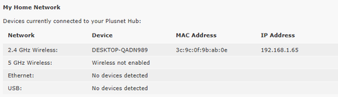

Is the wireless still turned off? Provided you only switch off 5GHz then 2.4GHz should still be present, with no wireless from the Hub then the TP-Link extender will not work either. The home page should look something like
I only have one device connected.

@Ennyoueffsea
Thought I'd give it a couple of days, how's things behaving since you turned off the wireless extender?
Tags (2)
Ennyoueffsea
Posts: 20
Registered: ‎18-11-2024
Re: Random Wi-Fi Disconnects Now Permanent
Hi Dan
Thanks for checking in.
I was online twice yesterday for short periods and laptop connected without any issues on both occasions.
Turned on this afternoon, again for a short time and connected fine. Have just come back on in the last few minutes and connected again with no problems.
I have left the extender unplugged for a few days now. Is it likely that the extender may have caused this, and is it best to just try getting by without?
Will see how the next couple of day and see how things go, but it does look encouraging.
Many thanks to you and @Townman for your patience.
Terry
Just tried disconnecting from router, then clicked on connect and held my breath. And it has again connected, so looking good so far.
