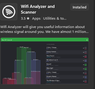

@Ennyoueffsea @Townman
This is a handy windows app, downloaded from Microsoft Store
EDIT: What must taken in to account is the wireless extender is likely using the same channel as the Hub One, it will not be possible to change it's channel

Thanks Dan
Have downloaded and run it and the attached is a snapshot.
Do you need a shot of the listed items on Channel 1 of the router?

So, a blue bar indicates a strong signal. Both your Hub and Extender have a strong signal where you ran the test.
Looking at Analyzer1.png it shows a strong wireless signal 'No name', this should not be off concern provided it stays on channel 13. It would be nice to try and identify what it is.
When in the app if you click the "no Name" in the listing it will open up a screen, this will detail to MAC address, provided this is the devices true MAC address it should be possible to identify the network device manufactory, following example shows a device on channel 1
Can you perform this for both "no Name" networks? Just share the MAC address number rather than a screen shot.
Channel 1 and 6 would be your best choice, I'd avoid channel 11 due to the strong signal on channel 13.
Be interesting to see when your laptop does not connect what the status of wireless signals are and which channel that '"no Name" is on.

Those plots are largely reassuring, with the exception of "No Name" everyone is playing nicely.  See how the channel 13 SSID overlays those on channel 11.
I also found this app in the store (which I find more informative) as it looks a lot like inSIDDer.  https://www.microsoft.com/store/productId/9N75W2M2D55F?ocid=pdpshare

My first suggested wireless analyser is a bit basic, but is functional for looking a channel usage, when I dive deeper in to wireless networks I use.
Also found in the Microsoft store
