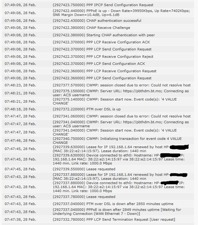

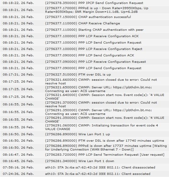

In the last two weeks my Hub One has rebooted itself 3 times. See 3 photos from the Event Log for 'PPPoE is down' events.
Each time it was not a general power cut issue. The power adapter was cool and firmly plugged in. The firmware is still v4.7.5.1.83.8.289.1.3 dated 2/12/2021.
There have been no changes to the setup since Openreach installed new cable and a new Openreach Master Socket 5c with Mk 4 Faceplate on 15th Jan 2022. The hub is plugged directly into the master socket.
Is this a developing hub or power adapter fault or a line problem?

Okay here is a photo of this morning's event from the 'Down' event to the 'Up' event. Hope it helps.

@Madeleyite That is an xDSL (BT side of your master socket) event. How many of these events, which seem to have a ~2 day  gap, have you had recently? Also your downstream SNR is a little on the high side, which would indicate there is an underlying problem somewhere.

Previous events were more random so nothing around the 2-day/48 hour period.
26th Feb event shows 17737 minutes (12.3 days)
14th Feb event shows 28189 minutes (19.6 days)
25th Jan event shows another 'PPPoE is up' event but no corresponding 'PPPoE is down' event.
See photos.

@Madeleyite Those events look strange to me - I can't see any 'down' events at all.
@Dan_the_Van , @MisterW  Am I missing something obvious? Or is it those 'CWMP' events causing this?

26th Feb 'down' event can be seen at 08:16:50 hours.
14th Feb 'down' event can be seen at 00:29:51 hours.
25th Jan 'up' event can be seen at 10:40:15 hours but there is no corresponding 'down' event for 25th Jan.

10:38:52 25th Jan there was was a system start, the following messages suggest a BOOT.
The other two message were a DSL drop.
@Madeleyite
do you recall restarting hub on the 25th or a reason why the system start would have occured?
