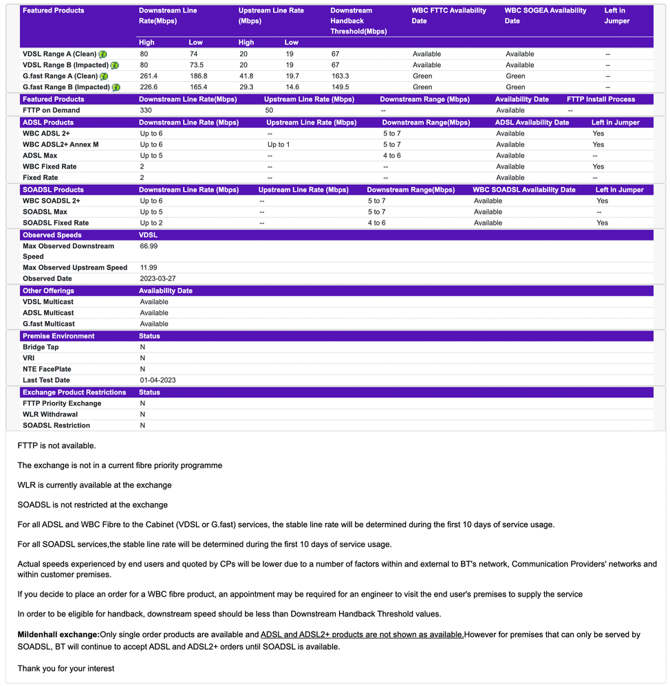

From what you have posted however, I would suggest reporting a BROADBAND fault - the download speed is below the handback threshold, so suggests a fault, on its own. From that BT page suggests you should be getting much higher d/l speeds. Note, though that upload speeds are not guaranteed, although you should be getting double your reported speed.

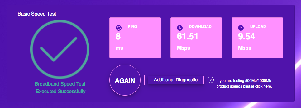

I repeatedly get this error on the BTw diagnostics though:
Your speed test has completed and the results are shown above, however during the test an error occurred while trying to retrieve additional details regarding your service. As a result we are unable to determine if the speed you received during the test is acceptable for your service. Please re-run the test if you require this additional information.

OK . Phone OK is good. the advance test is a bit choosy about whether it decides to work or not - unfortunately it is down more than it is up.

Jamie, the BT Broadband Checker results you posted earlier clearly show that your line is not performing optimally - as I said earlier, your download speed is below the handback (i.e. needs looking at by Openreach) threshold. If they fix that, it will (maybe) increase the upload, but PN won't want to go down that route unless pushed.

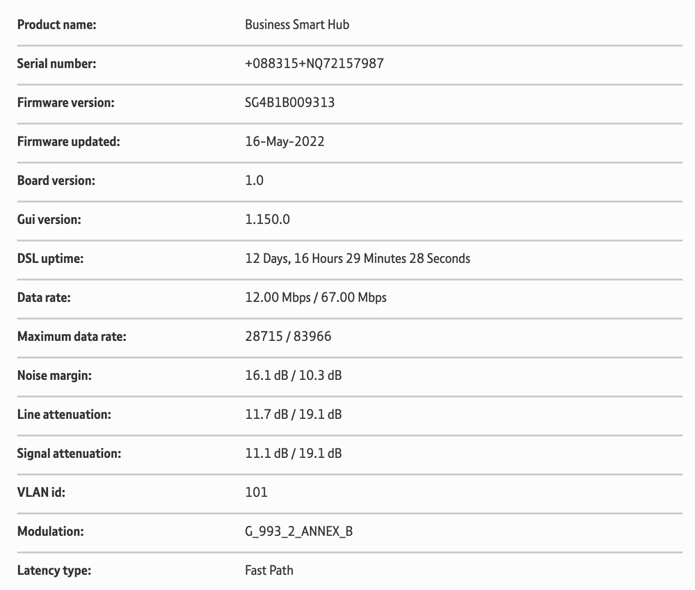

@jab1 From the line stats which are showing high SNRM values it looks to me that the line is banded on both download and upload, you would think that Plusnet would be aware of this and do something about it which would be to request a DLM reset.

Yep. Looking again at those line stats, @RealAleMadrid , it certainly looks banded, but a DLM reset my only temporarily 'fix' it - surely any underlying issues need sorting, for a permanent resolution?
