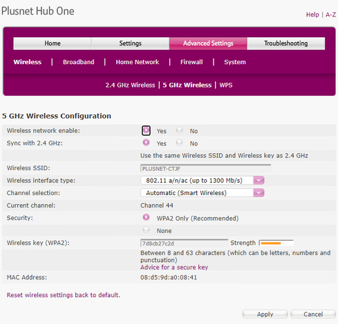

@raj-18 on the picture you have posted , select the 5GHz tab, not the 2.4 one.

Re: Plusnet Hub One 2.4 & 5GHz SSID configuration problem
@raj-18 if you change the 2.4Ghz wireless name you will change both the 2.4 and 5 Ghz as the 5GHz shares the 2.4Ghz name.
As John says change the name of the 5 GHz.
Change sync with 2.4GHz to no and change the 5GHz name to your choice and apply
