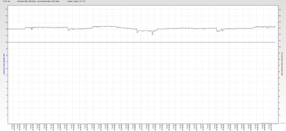

Since my last post the plot has been roaming between 10 and 11dB, as attached. The router appears to have remained connected, too...

You plots clearly indicate the presence of RFI - possibly two sources.  One is generating the square wave appearance (down the noise is present, up it is off) the other is more random and is causing the jitter.

Thank you for the thorough explanation, it's much appreciated. I can see I was fixated on the margin, rather than the margin ratio, but it's clear now. I've spent the last week trying to track down the RFI source. I attach a picture of the board where the telephone line arrives, which you can see is not ideal. I'm tempted to run a very short cable from the junction box and test the router with only that shorter length between it and the incoming feed, in case the length of cable is an issue. Although as it's been reliable all the rest of the time with the same cable I'm not hopeful that would make a difference.
There are no extensions or otherwise - the black wire comes in under the floor, goes to the junction box where it is spliced to the white twisted pair cable that leaves the junction box. The other end of that white cable is the master socket with the router and telephone base station plugged in.
Despite turning everything on and off I cannot work out what on earth is regularly switching every 20 minutes or so and causing the square wave. It's consistent day and night. See today's plot (10s logging rate, 2h per screen capture). I'll keep looking and poke the radio outside. The only other thing I can think of is that there is some kind of plant associated with a septic tank that may go on and off at all hours.
Routerstats says the connection has been 'up' for 7 days, so it hasn't been dropping. The connection speed and maximum data rate are reported as completely flat lines all week. However, the connection from a user perspective has been poor, with highly fluctuating pings and lost packets.
Running some command line pings to the BBC website over the last few hours has resulted in 27ms - 300+ms within the same four-packet test, and many where 50% of packets are lost. The telephone line quality isn't notably noisy. The router event log has numerous entries of the form "OUT: BLOCK [65] First packet is Invalid (Invalid tcp flags for current tcp state:..."

That looks like some level of progress.  Though there is still clearly something switch off and on (on more than it is off) it looks as though some background noise has been removed.
That incoming line is about as bad as it could possibly be - wrapped around the inbound mains tails and close to the street fuse!!
Do you feel comfortable moving that junction box to the far right of the cupboard and tacking the inbound cable well away from the mains feed?  It is pre the master socket, so technically BT Openreach's exclusive domain.
