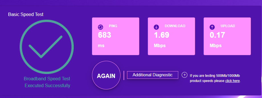

Update:
I've changed the router from the Hub 2 to a Zyxel (from my time with John Lewis BB).
After about an hour, speed dropped as previously:
I don't know how to get a proper log out of this router.
This would seem to suggest it's not the router but the line.
Posts: 25,301
Thanks: 9,151
Fixes: 387
Re: Intermittent slowdowns
@hugonebula I don't know if it is the Openreach line/equipment - I only saw one 'DSL Link up' event for the time period you were talking about - but strangely no 'DSL link down', as I would expect. I can't remember if you have said, but is your Hub connected directly to the Master socket, or is there some intervening cabling/equipment?
