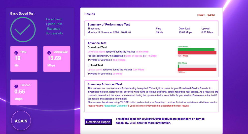

Weirdly nothing comes up when I try to search on https://www.broadbandchecker.btwholesale.com/#/ADSL/AddressHome even just by postcode
And unfortunately, I don't have an ethernet cable so I just ran the test wirelessly again...
and for

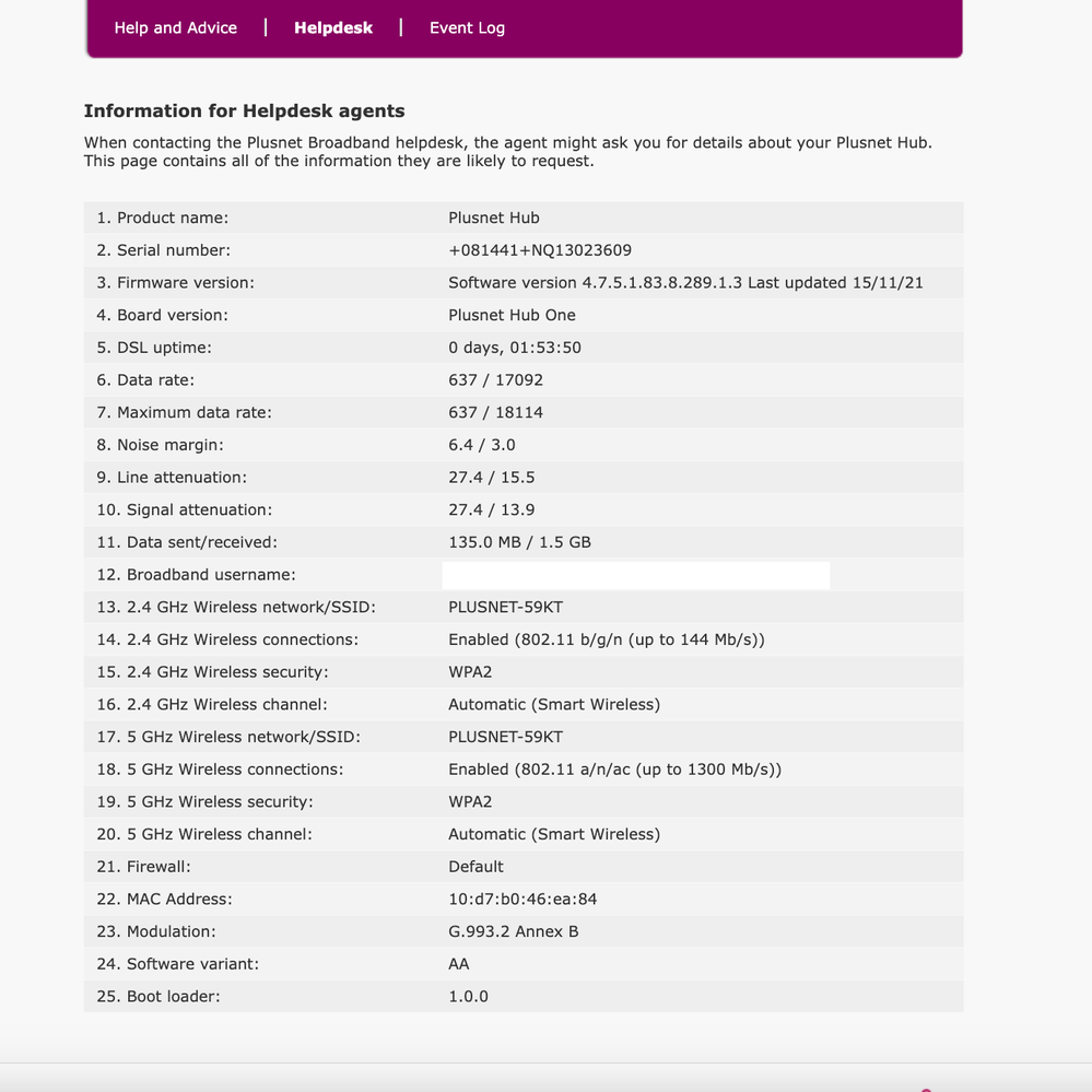

For the Hub One -
Navigate from the Home Screen to Troubleshooting > Helpdesk...
and unfortunately, I've no phone to test the line

Pity you don't have a phone, but what you have posted is enough - report a broadband fault via: https://www.plus.net/help/report-a-problem/  and please let us know the response.

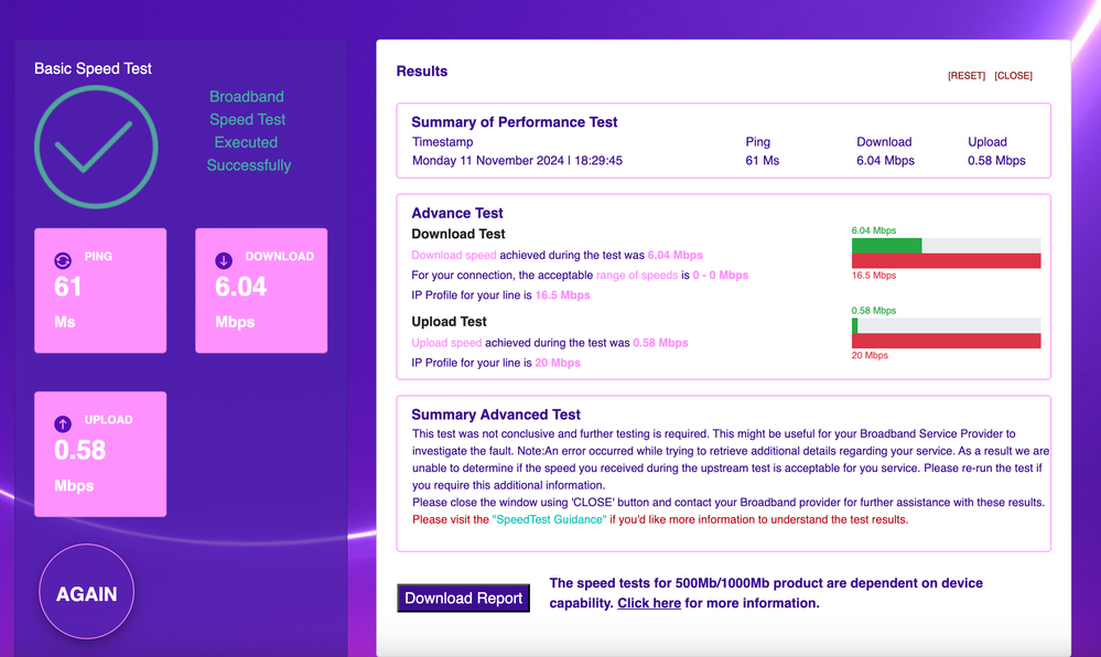

Getting worse, just carried out another test. Is there any way to escalate on here as seems easier to diagnose and solve with screenshots etc than over the phone?
