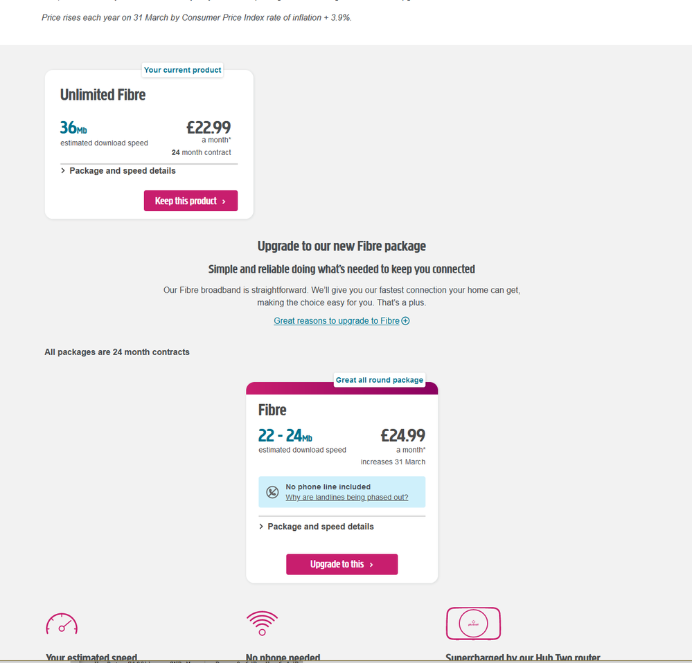

Then If you add Pnets changing of speeds for the area on thier website pages to the speeds they are capping to , some what laughable - if I were not paying for more for the subterfuge.
Oh I can get a 'Fibre' package - a further 4 Mbs slower   than the 27.4Mbs I am being hard capped to   ( guess where the next hard cap speed is going to hit ?)
Pretty soon  I shall No doubt be at ADSL speeds  In this rather pathetic marketing ploy.

Im not holding my breath tbh .   This is the  "deal "thats  being offerred to me  And the speeds they are going to drop me into -  one way or another.
Maybe its my paranoia who knows but that is  A definitive slow down in offered speeds.
Just wish I had saved my router logs earlier  Mind you that would have increased the frustration
Re: How low will Plusnet slow down connection speeds to force FTTP uptake ?
Plusnet's offer speeds are individually calculated from Openreach's database, which is based on the current performance of your specific connection.  While you have an ongoing fault, your reported range of line speeds will be lower than expected.
Once your line is repaired, then the numbers will recover to mirror the improved speeds.

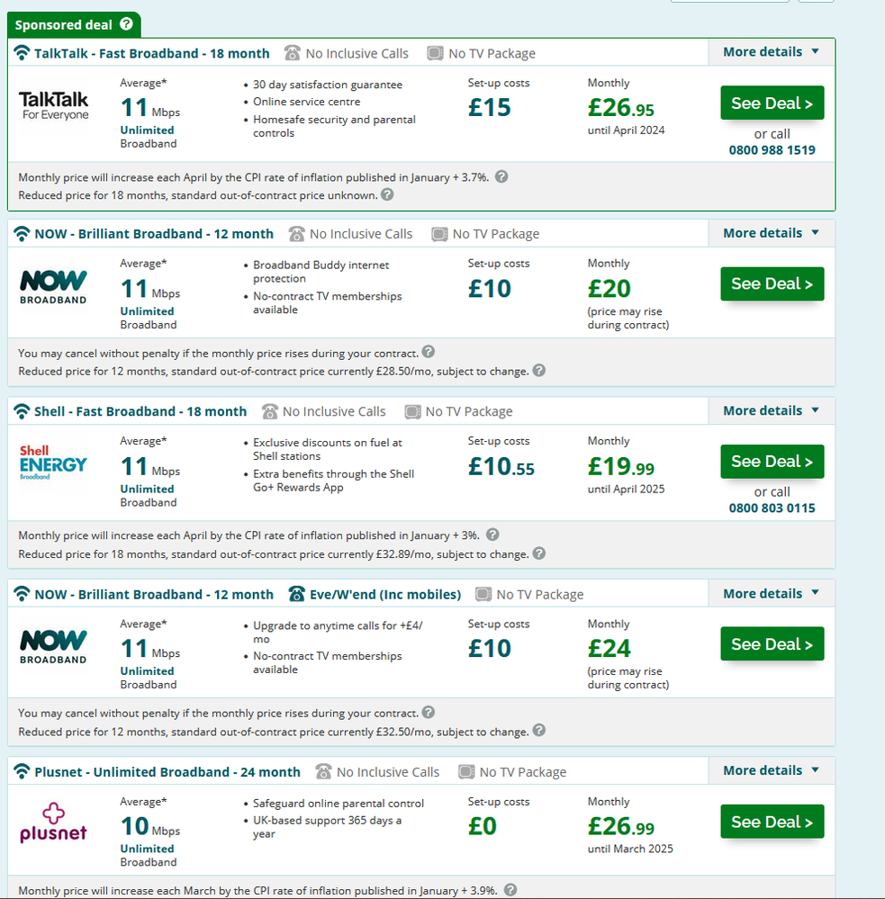

Looks like the writing is on the wall for My area .. Current  "Deals" being offered on FttC with a landline to new customers.
Bt Wholesale are probably using the Marketing equivalent of constructive dismissal.
For me it is more cost effective to have the VMedia 350 Package for my internet needs  and let this current contract run its course. and keep my land line running for as long as possible..    Rather than cancellation , paying early termination and re-sourcing ..
Will see how well the engineer can stabilise the line again Still not holding my breath  for anything like the speeds of  6 months ago
