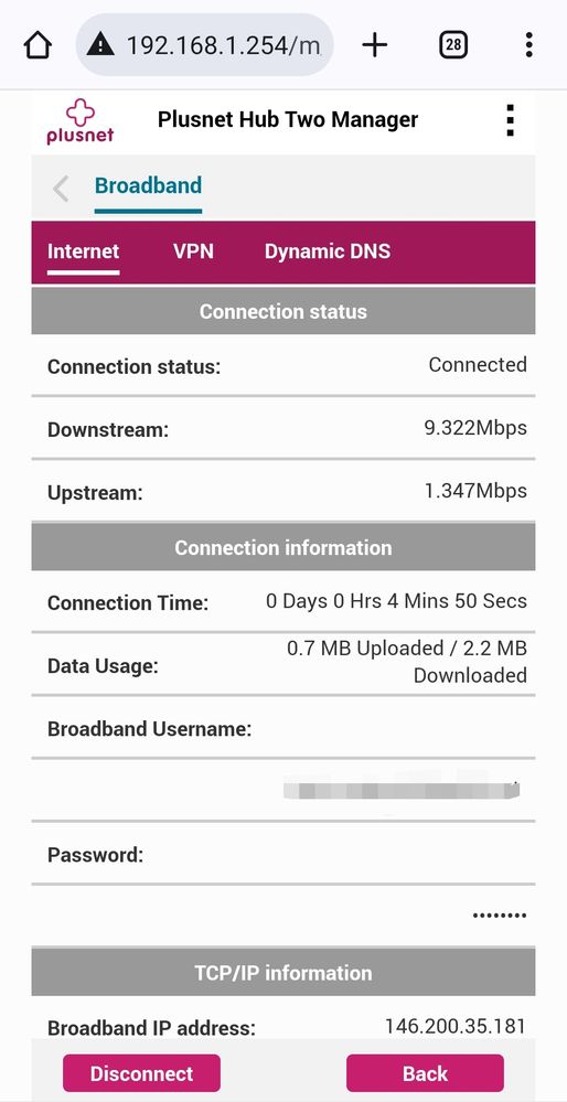

@Bridiebabes If you are on SOGEA, a screenshot of your connection status page, as in the  picture below, is useful. Please. Obscure personal details, though.

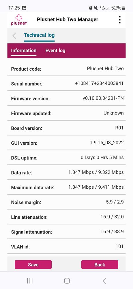

@Bridiebabes Sight of this page would also help, please:

Sorry how do I add screenshots like that?

@Bridiebabes Thanks for that. Assuming you are on FTTC, please follow the below - you have a major issue.
If the phone test passes, report a broadband problem via: https://www.plus.net/help/report-a-problem/broadband/
The above assumes you still have 'normal' landline connection - if you have a SOGEA (internet only) one, just use the second link to report a network issue.
