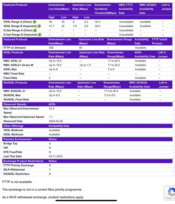

Have you checked recently as to wjat's available at your address. If you use the following and post a screenshot after hiding your details it might help.

Connection Type - Broadband (DSL)

Hi. Thanks. We have concerned about moving to Fibre and loosing out Land Line. We have lots of power cuts -

@CaseSensitive  I know it's easy to be wise after the event but you should have considered moving to VDSL2 (FTTC)  before the stop sell on the copper phone service last September. You can still change to SOGEA but you will have to set up a VOIP phone service which of course is problematic if you have frequent power cuts.

Thank you. I’ll try this. Will moving to Fibre (not Full Fibre) solve my problem?
Still very concerned about using our Land Line. We live in a rural area with very limited cell coverage and need WIFI Dialling to connect. When our power goes out so does the cell mast. Leaving us isolated.
Your experienced thought much appreciated.
