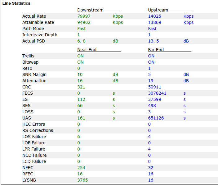

I do not have a phone and the router is Draytek
My line is plagued with issues. The line is patched to all heck heading to the Cab
It just needs sorting

Fair enough if you have a dodgy line, and agree it needs sorting, but I can't honestly see anything in that screenshot which could account for the behaviour, apart from possibly the upstream error figures, which are extremely high.

As I said, the speed to your router is perfect, but the u/s error rates are horrendous. An engineer visit may solve it, but may not.

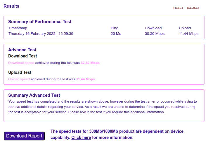

What does a speedtest show at the moment, preferably the https://speedtest.btwholesale.com/ one, including the 'Additional Diagnostic' detail?

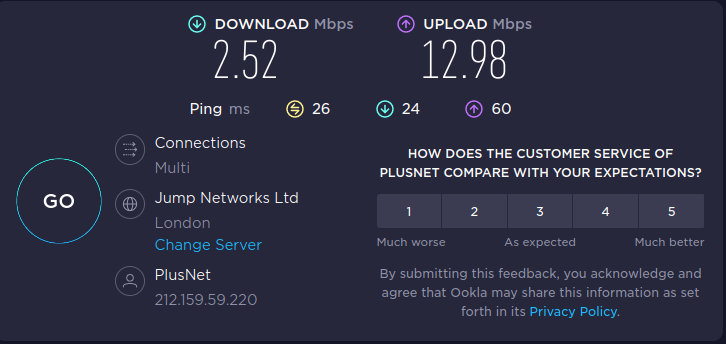

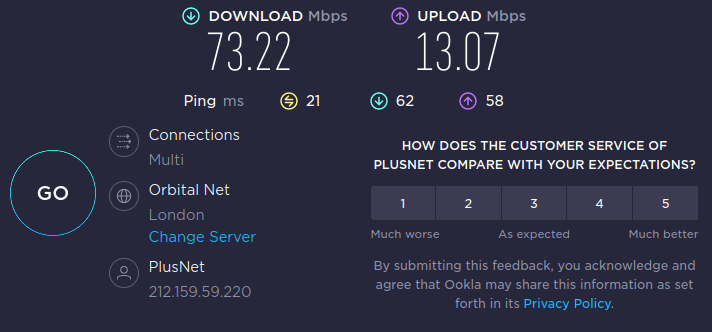

It's confusing because it's different to speedtest.net
And it seems to imply a faster download speed, that actually has little reflection to what is happening on all my devices.
I'm basically crawling along

And again with speedtest.net
Is probably a true reflection of how slow it is

That's quite a big difference between them both @superuser
Was one of the tests done on a wired connection and the other on wireless? Were both tests also done on the same device or different one?
If a wired speed test hasn't been done, would you be able to do this and send across the results please?
