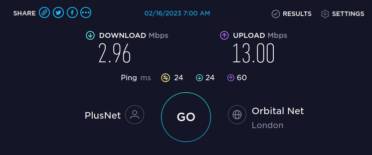

No drop over night
But the connection is speed is down from what is has been for a while at near 80
to as seen in the attached

Slow as treacle
Really slow today.
Just seems like issue after issue. And I still get disconnects regularly to as per this thread
